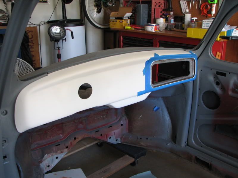

So here's what I did with my dash. I bought a fiberglass blank one from Glass Action in Prescott Valley.
It fits very nice and lets me put the guages where you want them.
Like the ragtop frame, I glued it on with urethane windshield adhesive and filled some cracks and air holes with that foamy expanding stuff from Home Depot.
It's plenty solid.
I like it because it still has a bug-like look, is customizable, and paintable.
It also lets me do something unique (I think) with the glove box.
It was fairly easy to cut out the opening for the glove box and smooth it in with some kitty-hair type filler.
For the most part, the dash fit snugly, expect for around the glove box, which was where I needed to reinforce and smooth it in anyway.
Instead of closing it up and loosing it, I figure I can make a cubby hole and put some bungee type netting in front. Something like this, from a Ford Escape rear compartment.
