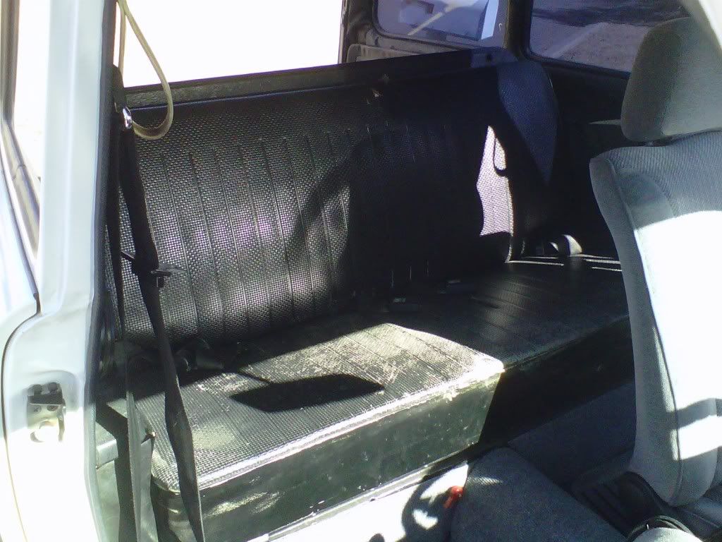

The previous owner did a lot to clean it up. repaint, new window door and body seals. I've cleaned up some wiring, lights, horn, wipers, stereo, etc... What I know about it- was built by a now-closed shop in Seattle area. Cut & boxed wheel wells, disc brakes all around, supposed to be a bus transaxel, dont know gearing. Has a 1776 engine, lightned & balanced flywheel, paper work with it says a V2-15 279X478 cam and dual Empi carbs. 31X10.50 tire all around.
[IMG]
