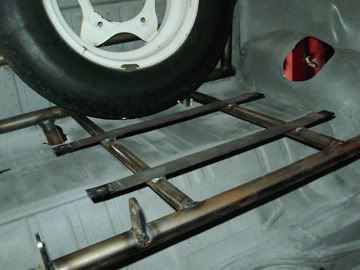

Took some time to clean up the firewall and rebuild the rear suspension and brakes.

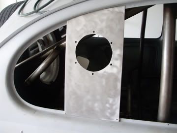

Did a little work on the hood. I think the results are pretty good.
Front suspension is next.

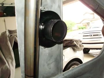

Working on the brake lines, pedal assembly and fuel filler neck.

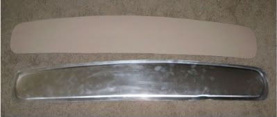

Took some time this weekend to start the wiring of the car. New dash was the first requirement.
Time to fill the empty space[i]

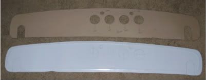

Use the new dash and some cardboard for a template.[/i]
Create template and trace onto the white protective film that comes on the dash.
[i]
Used a hole saw to cut what shapes I needed and a dremel tool to touch it up. VDO only gives a few mm for error. Measure twice, cut once.[/i]
Finished dash with all new gauges and SunPro Monster tach.
[b]
[i]
New dash fits great. Take a lot of time to measure and remeasure. I cut 4 templates before I transferred it to the actual dash.[i][u]
