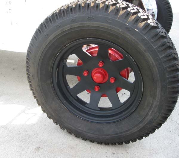

If you going to Baja it you can scrounge up a free or cheap bent beam you can widen it. For a stock fendered Bug you can also just beat the edges of the body and pan flat and live with the noise. This one is 9" wider. Three or four inches should work on your bug.
Some killer tires bought in Mexico.

Also do not use stock VW rims. get a set of the white wagon wheel type rims. You gain from 1" to 1.5" of width per side over the stock VW rims.

heres my rims...you can see how much farther they stick out than stock rims...
if you compare with perribs rims...
btw these type of rims are officially called "spoke" rims so if you search those you find what you want.
there like $50 new so there nice and cheap.
the stock ones cover up the whole brake drum. mine only cover it about 1/5 inch...you can see almost the whole drum from the front..

thanks,,,just showing,,white spokes,,i have disk in the front,,,,but you can get them in just about any offset you would like!
