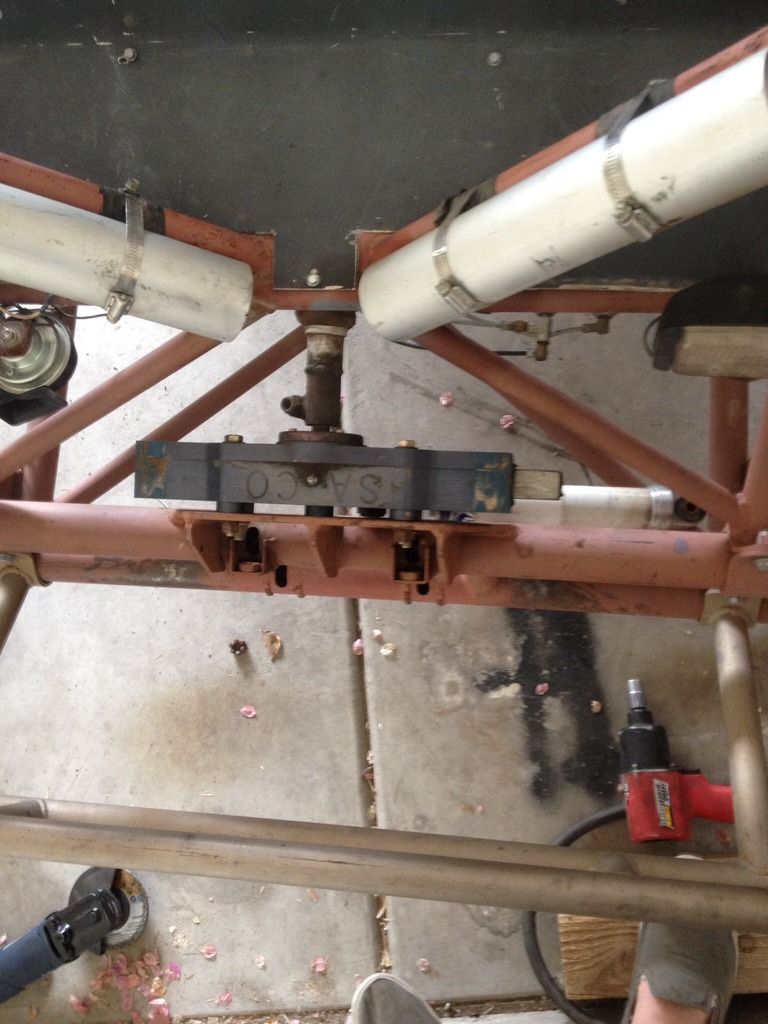

First on my car were the shocks and rack
My old rack was 1 1/8 turns lock2lock wiith4" travel, Saco is 2 turns L2L with 5.5"" travel so feels a little lighter but not much
I took a little off the stops and was very happy with the new radius

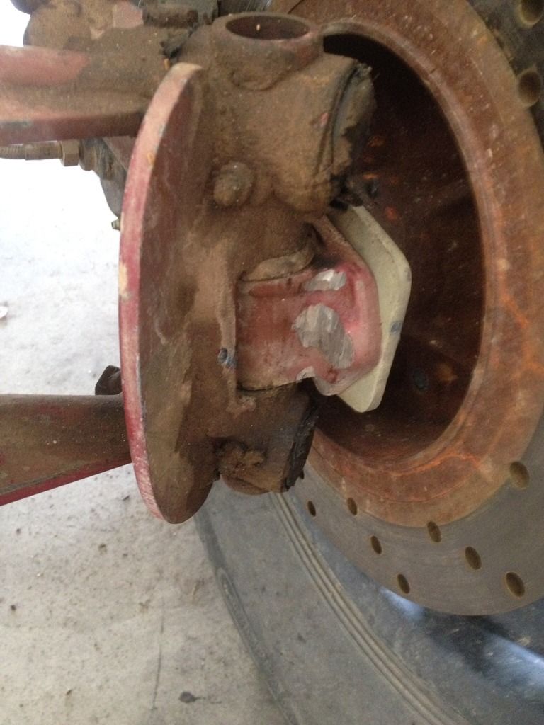

The verde run showed me how heavy this car can get 3 up with full camping gear so I replaced my stock spindles with the funky combos, the realized again my arms were about to lose a coil over mount
I don't know what these things are made of but I've been beating them with 7.50-16 tires that are almost 33's for years and they took it
. A little grinding and some paint makes me the welder that I aint. 1TONHOE

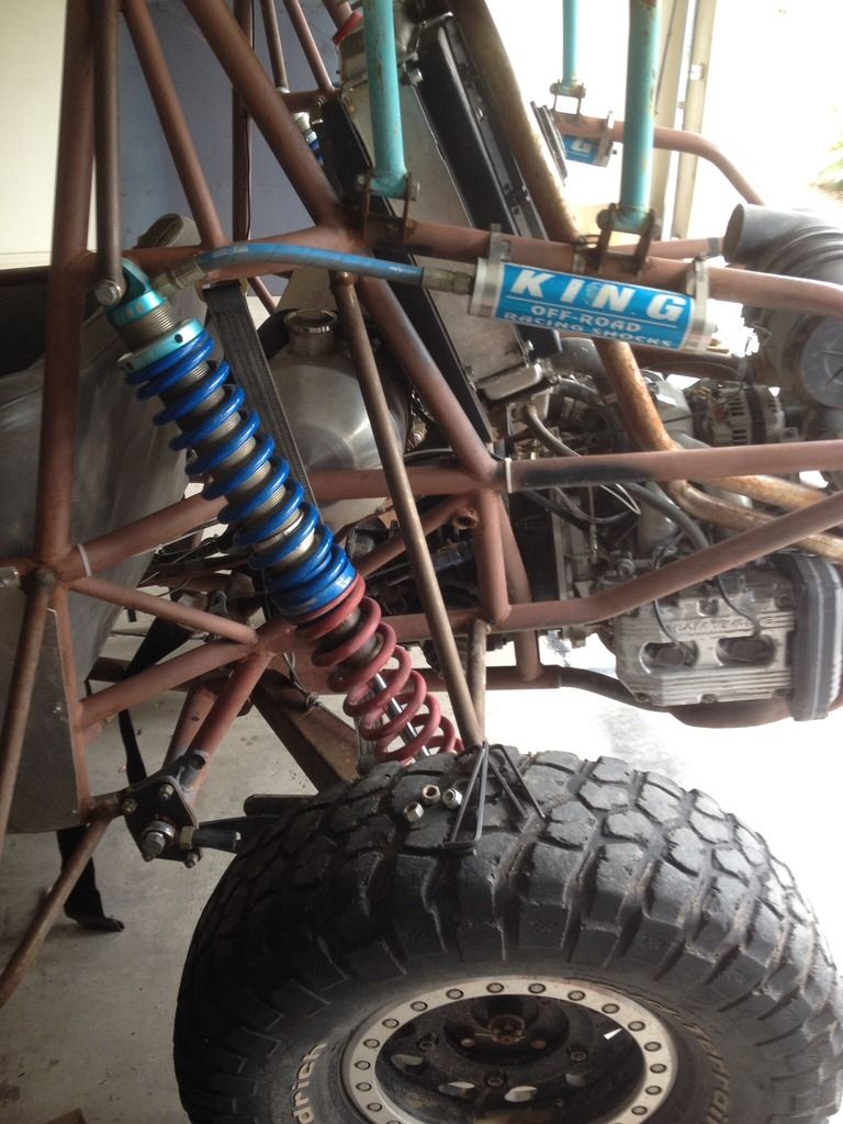

Got my arms today, just test fit em for now to see if the tie rods were going to clear diagonals and bottom tube with room to spare and it looks good! I have the tie rods from the other car I can lengthen as needed, and my shocks kinda point in at the bottom so I might double tab the arm mount and center my shock over it
