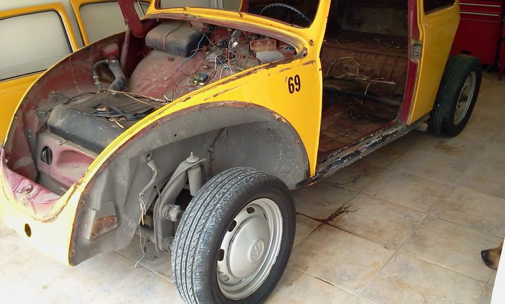

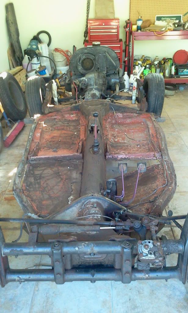

Hi guy's,
What I thought would be the easy part (removing doors and fenders) turned out to be a real struggle! Boy, did those nuts and bolts put up a fight. Evil or Very Mad
It looked like they were fighting for their live which really was the case since most of them lost their heads in the process Crying or Very sad
As you can see from the pics the car has a lot of rust. Also the wiring harness looks a little different from stock.
Next step is removing the body.

Wow, could use the Flintstone feet there! Hopefully you have good metal to add the replacement pan halves too.

To be honest, I'm not sure yet. I have to wait and see what is left after cleaning everything.

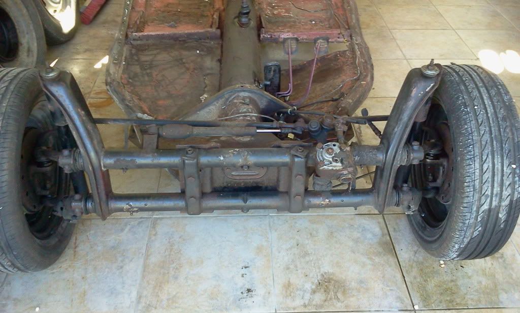

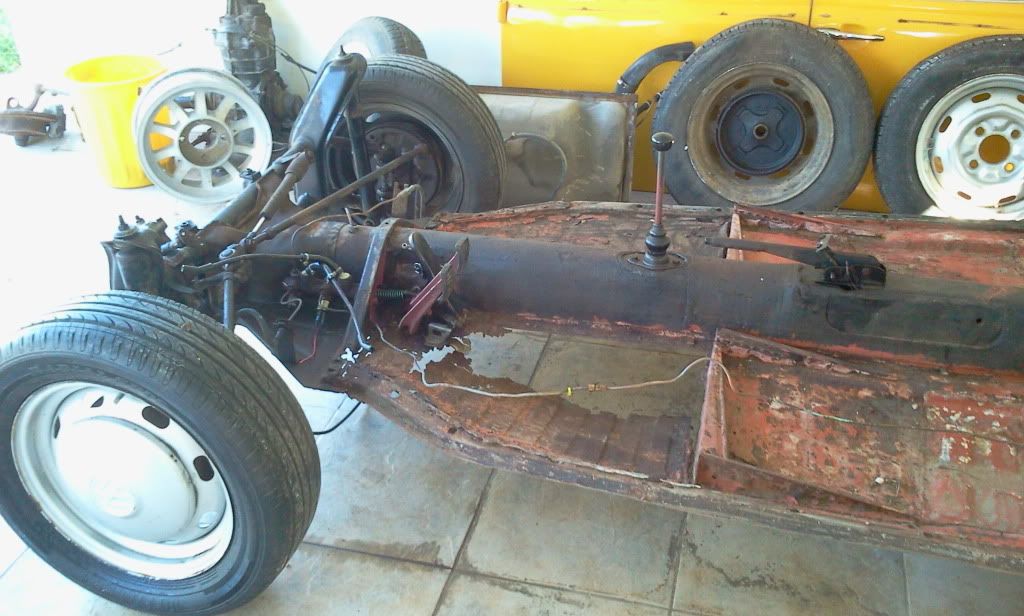

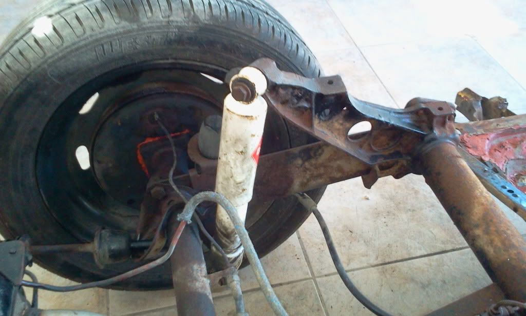

Can you tell me what the english name is for the front and rear suspension is that I have.
Just to make sure when ordering parts I'm using the right names.
Thanks.
Post Post subject: Building a Baja '69
Posted: Sat Sep 08, 2012 11:18 PM
Looks like Swing Axle in rear and Ball Joint front?
There's something coming off the back of the Swingaxle I've never seen before?

That's suppost to be straight-up. Its connected with a bar to the other side.

Since it has the swingaxle it will be a 1968 not a 69. In 69 they were IRS rear axles.
Post Post subject: Re: Building a Baja '69
Posted: Sun Sep 09, 2012 03:00 AM
Ah Ha! It's a sway bar. I never saw one on a VW in the rear. At least all the VW's I had it was already removed. Thx.
