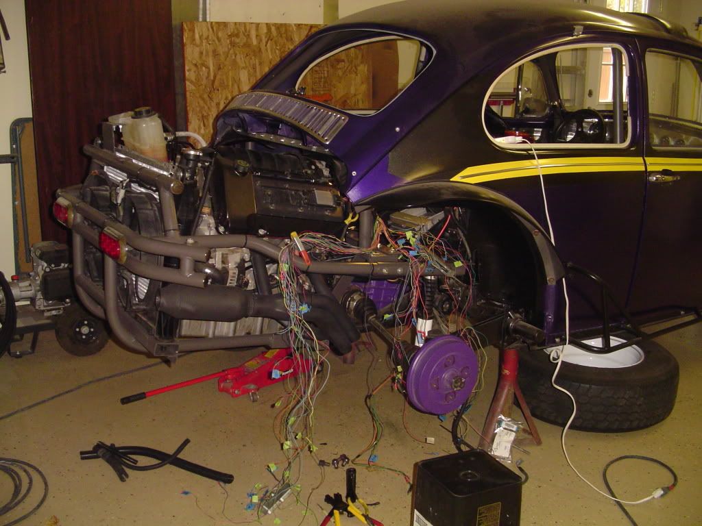

Well finished welding the rear bumper and frame supports. Got it all painted. Got the headers installed and tail lights all wired. But some coolant in the radiator and would you know it the thing has a leak. Guess thats what I get from the wrecking yard. Pulled out and took to radiator shop for repair. Hope to have it back in a week. More when I get it back.

Time for an update. The old radiator was scraped and installed new one. Got coolant topped off and started. Drove it out of the garage into the drive way under its on power and let it run for 30 min. Never got worm to turn on the fans. I hope that is a good thing. Drove it back into the garage. I ended up wanting to shorten and clean up all the engine wire so it is not running.
Post Post subject: My project
Posted: Fri Oct 26, 2012 01:54 AM
That was quite a job. Shortened all the wires that were left going to the pcm. There were 52 of them put all new ends going into the module. Got that done and tried a trip around the block. That was fun a little cold Shocked without the windshield and temp was 42 today. I still need to adjust the shift rod and shifter. Clutch and accelerator work great and it stopped straight, all the things that have been worked on and they work. Laughing

pepeazul, I found the best price and quality at Mouser Electronics.
GM wants $1.50 each that was way to much. The ones from Mouser look identical and have the same rating.

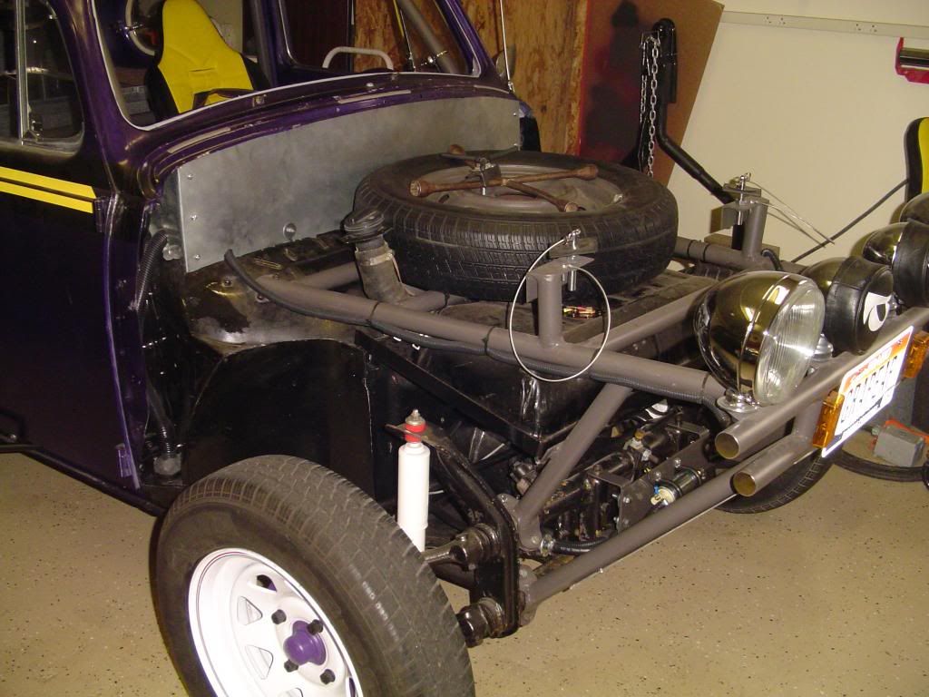

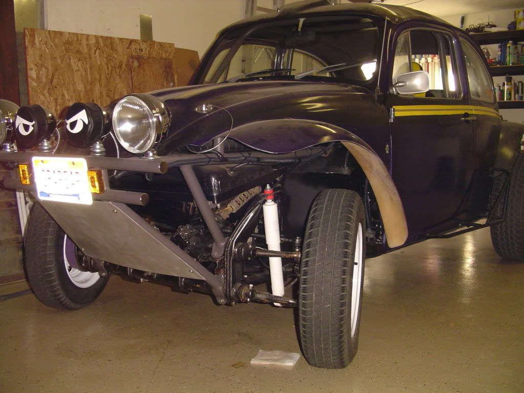

Did a little more work on the front end this time. Relocated the fuel pump on a bracket on the front beam. This made it much quieter. Got the spare tire mounted and ready to go.

hey im currently building my own baja and ive been wanting to build my own front end and i like urs. I was wondering if you still have the dimensions fr that front end so that i can base mine off of it
Any reply would be really appriciated!
Posted: Thu Dec 06, 2012 05:26 AM
Cant say that I had any measurement. I just went to cutting, grinding and welding. I can put a tape to it and give you some rough measurements.
Give me a couple of days and I will pm you some numbers and other pictures of the build.
