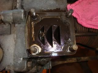

I've been busy on the Squareback the last month. As I attempted to take it to Bill at Affordable German to get it to pass emissions my clucth started acting funny. Low and behold the springs on the clutch plate some how dislodged themselves and started tumbling around in there. OOPS!
DustinT3
DustinT3
Joined: Nov 28, 2010
Posts: 46
Location: Phoenix
Post Post subject: Re: Squareback attack, the Ugly Orange Squareback
Posted: Sat May 21, 2011 11:34 PM
Anyway, you know how it goes, one thing leads to the next....
I figured, well, since I've got the motor out I may as well take it apart and clean it all up. Remember this thing had sat for some 25 yrs. I kept finding more and more grass in places I couldn't even imagine.
Look closely and you can see the spring to the auotmatic air control unattached and just hangin' out.
Posted: Sun May 22, 2011 12:01 AM
Look what I found "deflected" on the deflector plate....
That would have "screwed" (pun intended) things up real quick if it had fallen through.
I'm glad I decided to take everything apart!
