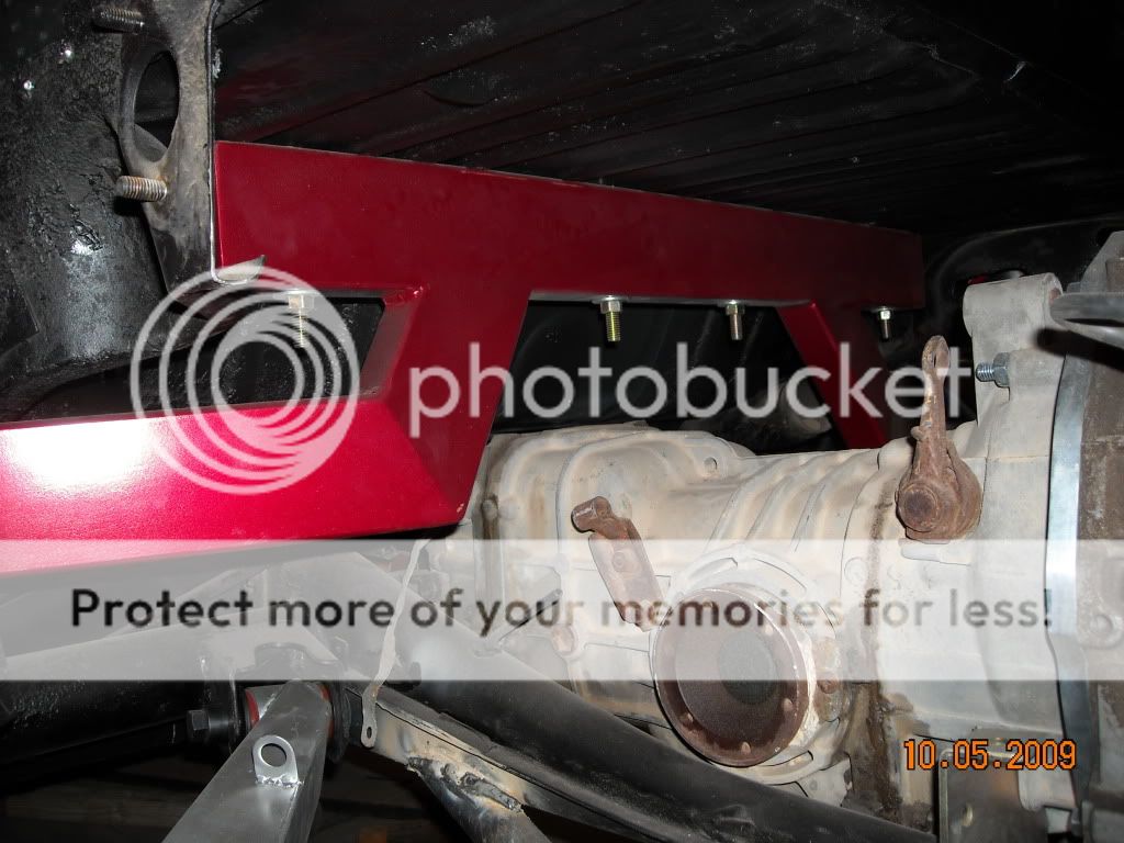

Wow this thing is just amazing and im sure you never get tired of hearing that. i like the way you did the shock mounts in the rear also i was wondering if you could take some more pictures of that rear frame under the car. I am interested to see how it mounts. Smile

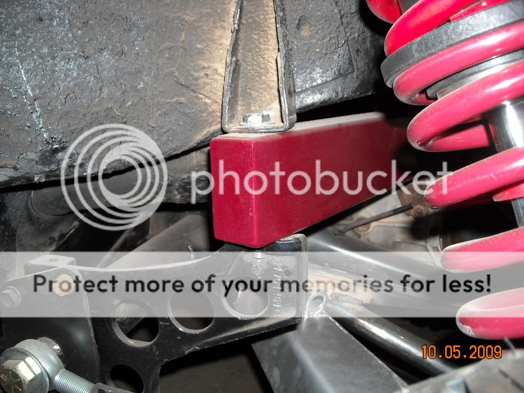

Had a day off today, so tried to spend some time on the car. Did some work on trying to finish the 3" body lift for the front and back. got all the pieces welded together, now just need to get them put in and get the body anchored down. JumpinBruceB, I'll get some pics for you. I assume that you are refering to the red piece that is just above the trans. It anchors on either end to the upper shock mount at the body attachment point. It then bolts through the body to then inner cage. I'll get some pics in a couple days.
Post Post subject: Re: Baja Ghia
Posted: Tue Oct 06, 2009 06:22 AM
JumpinBruceB, I finally got some pics of the frame you were asking about. The first shows how I attached them at the ends to the original body mounting locations to make up for the 3" body lift on the rest of the car.
The next one shows how the frame piece goes up and over the trans and bolts through the under side of the body and into the silver frame piece that the upper shock mounts are attached to.
The four bolts that are in the above pic are the same as the bolt heads in the bolts below.

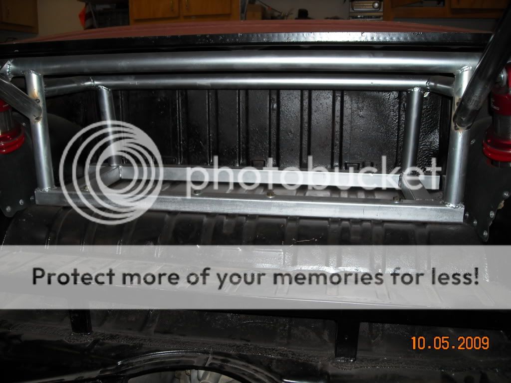

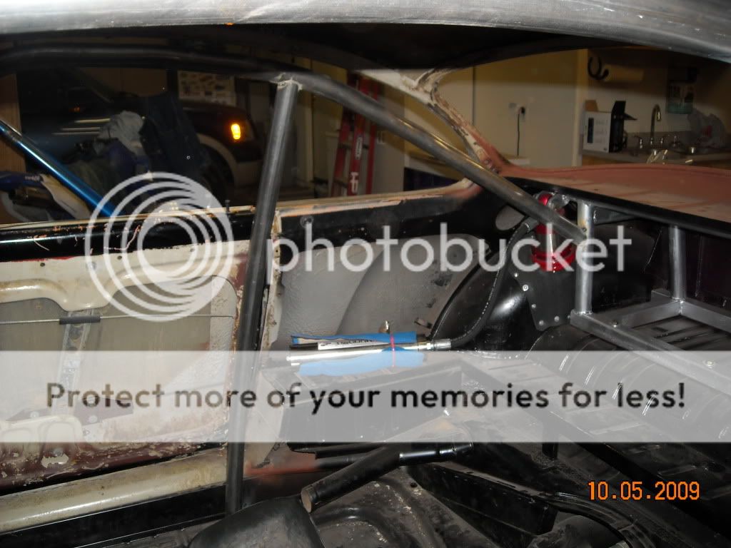

The last pic shows how the roll cage on the inside of the car sweeps back and ties into the silver frame.
This is kind of my own design that I put together with a lot of sitting in the garage staring at the car. I'm curious as to any other thoughts anyone may have about the design. Keep in mind that I still have several more pieces to add to the roll cage that will finish everything. I also plan to attach the back part of the silver cage to the upper attachment points of the trans as well as the limit straps for the suspension.

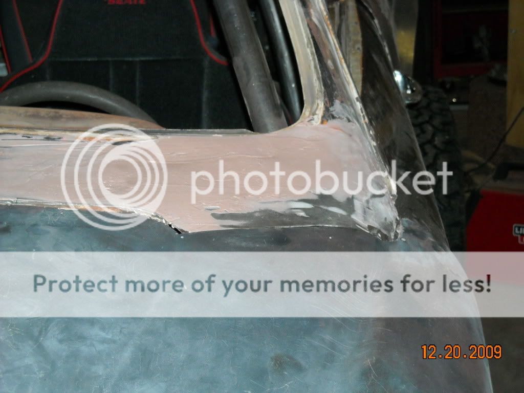

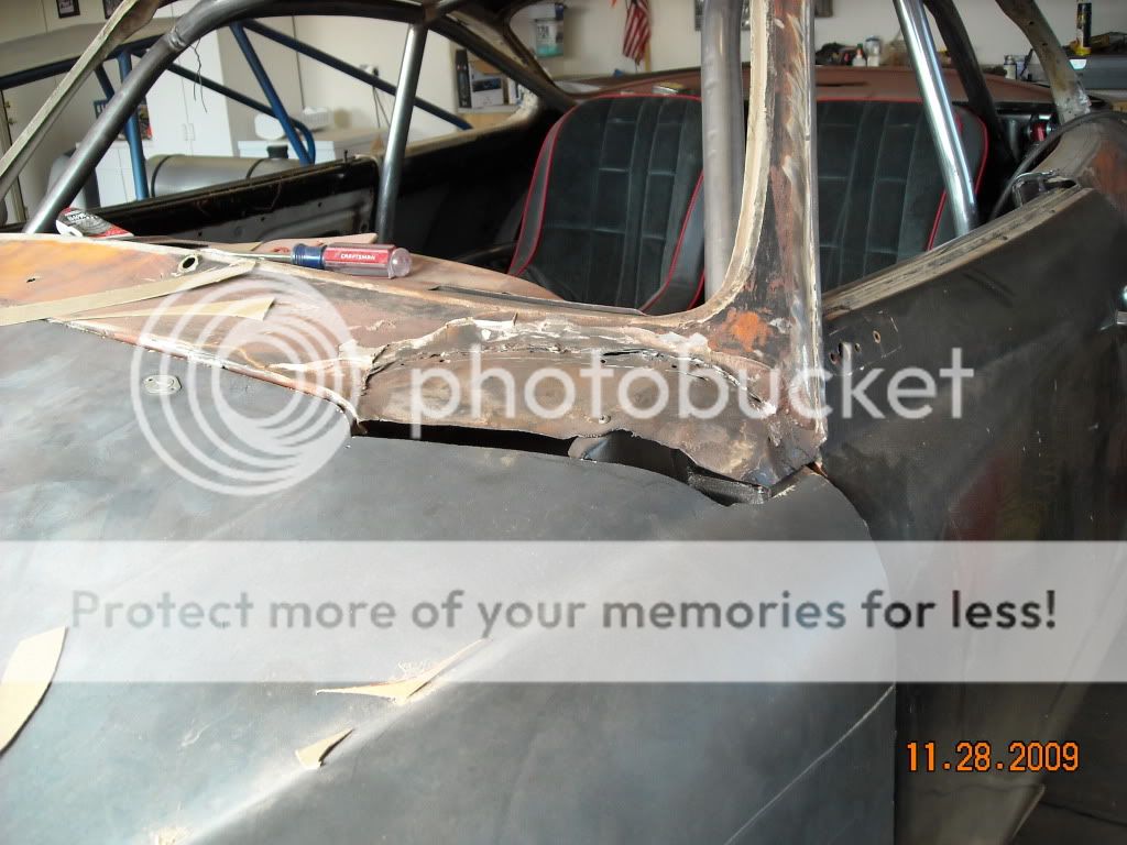

Guess I'm a little behind in updating the build. It's been a busy couple of months so garage time has been hard to come by. Been doing some body work. The base of the front window pillars had considarable damage, so I had to weld in a new plate and bondo in the area.
Much better but not quite done.

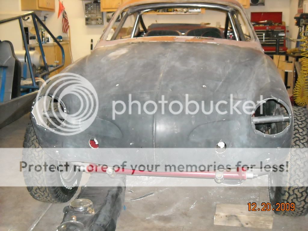

Also got the headlight buckets cut out of the front end. Since I am making it street legal, decided that I would try the basic "Baja Headlight" buckets for street use, then I have some Hellas and Lazer Stars for offroad.

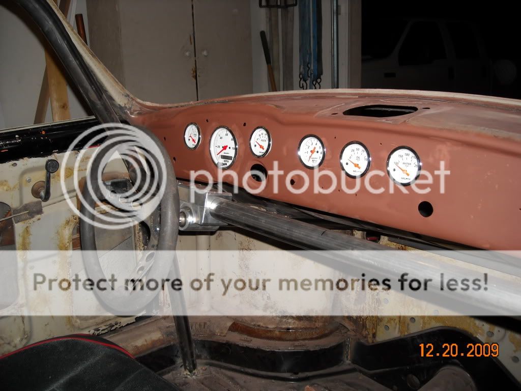

Last night I also tacked in the cross bar below the dash, so had to try out the fit for the steering mounts, then decided now was a good time to see what all the gages look like. The six gages are, Speedo, Volts, Fuel, Tach, Water Temp, and Oil Press. I thought the little Tach was kind of cool. All are AutoMeter.
