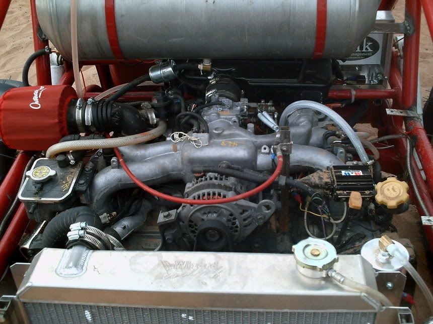

I notice that this discussion is mostly based on the Ford 2.3. This is a good motor, I don't think many (who know engines) would argue that. I am an performance engine builder and designer for a living, been one for darn near 20 years. Arguing "best engine" with someone is pretty much pointless. Normally, both sides have their mind made up and there will be very little that would change the mind of either side. So if I guy thinks the air-cooled VW is the best thing ever...and he has one...who am I to try and make him unhappy?
However...there are a few things that I personally feel people should NOT do when trying to defend their engine choice, whether it be air or water cooled. One of the biggies is stating negative things about the other without having any real facts to back it up. A statement was made that a water cooled power plant is just too heavy. In many cases... I feel that this is true. With saying that...I do NOT think a generalization should be made that ALL water cooled conversions are too heavy.
Here are a couple of facts to mill over. I have a large digital platform scale, the type a vet uses to weigh horses (accurate to the pound). Now depending on how you dress a type one VW engine, they fall between 210 and 220 pounds, ready to run, pretty light. But, lets do the same thing with a 2.0 Subaru engine. The engine with no radiator, adapter or ECU weights 257 pounds. Now add the radiator...8 pounds, the plumbing..4 pounds (on a rear mount radiator)...2 pounds for the fuel pump...the ecu 1 pound and the adapter plate 11 pounds. Lets not forget the water, a rear rad takes just a little under two gallons, lets call it two for the sake of argument. Water is 8.3 pounds per gallon, so that's 16.6 pounds. Now we are at a total of 299.6 pounds. Lets split the difference on the VW and call it 215 pounds. We now have a difference of 84.6 pounds. The weight of driver and his gear can fluctuate that much...I probably have 80 pounds of weight on an average size guy. So the weight issue is really not a good one to stand on if making a comparison with a Subaru conversion.
If you would like to have some 100% facts (not opinions) on the actual cost of a Subaru conversion, how much power it REALLY puts to the tires (I have a chassis dyno), I can answer those questions.
Again...if you want to make a motor choice by facts and not opinions, I would be more than happy to lay out exactly what it takes as far as time, money and skill level needed to do either air or water. If you just want to talk about which one you personally like better than the other, that's fine too, but don't bash one side with things you THINK may be bad about them. Get real information to back up what you are saying, it goes much further when trying to make someone understand your side of things.

This is what a 2.0 turbo-ed subaru looks like in a rail.
And here is a shot of it in action.
My dad swears by that little 2.0. I thought I had heard that a lot of the 2.5s were having problems? I could very well be incorrect, but it seems like I remember reading it somewhere. I will say this as well nube, if you plan on running a stock type1 trans, you better be real light on the gas in first and second or you will tear it up quicker than you can believe.

You can definitely run the subaru hard, just not with a stock trans. If you were to get an 091 bus trans or another beefy trans, you should be able to run it real hard. I would think you could get a subaru, adapter plate, wiring harness/computer, and anything else you may need for it and still have enough left out of that 5k to get a decent trans. Darryl or someone who really knows what they are talking about should be along before too long and they will have a better estimate for you than I do. lol. My dad already had a built 091 in his rail when he switched to the subaru. I believe that he spent just under 3k for the subaru and all he needed to put it in the car.
A sword never kills anybody; it is a tool in the killer's hand. - Lucius Annaeus Seneca

Check out page 5 of this thread Athlon. My old man runs a subaru in his rail. It is definitely worth getting the set up right and doing a subaru in my opinion. My Uncle had a 2.3 Ford in his until my dad got the subaru. Haha! Once he saw the power those things can put out and how small and lightweight they are, he started building a new car and tailored it to a subaru. He finished last year and that thing will move! His top run down the sand drags at Buttercup he was hitting 76mph and not running that hard on it since it was the firts trip out on that motor. The subarus are a lot of fun if you are going to go water cooled.

WOW that Suberu looks KICKEN!!!! Thanks for the info! I might go for one of those, is it carburatiored or fuel injected. I Like carbs. Wonder what kind of fuel mileage you would get? And looks alot cheaper then a new gold plated vw engine, I still can't beleve $500- $700 or more for a new case, and $150-$400 or more for heads. You know Alumnium prices have gone way down now. Man I can get a brand new target chevy 350 for $1500. This is my first rail. and I am shocked at the engine prices $2400 to $3200 for a stock 1600cc Well Im going to build along untill i need a engine. Becouse i don't have one. And make a descision then i gess. Well Fuel Is down right now but won't be for long, and the rail im building is going to be street leagle and dirt run. Hopeing to get great gas mileage with it useing a stock duel port 1600 if I can afford one. Im in florida and parts are hard to find here. So I will probley have to build one out of new parts.

It is fuel injected. I couldn't tell you what kind of mileage they get though as he doesn't run it on the road and never really pays that much attention to that kind of stuff in the sand ya know? An yeah, engine prices are crazy right now. I was lucky enough when I seized my 1835dp to find a 1600sp for 200 complete. Switched out the gen. on that one for the alt. on my other motor and a few other things and was ready to go for next to nothing compared to every other price I have seen lately.
