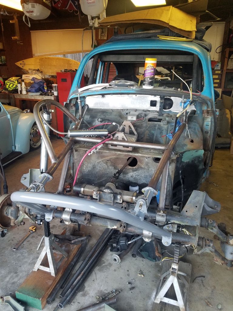

It sat like this for about 7 or 8 months while i had other stuff going on. Worked on a little side project for my friend. Amazingly got a T3 turbo and massive holley carb installed and running and fit under the hood of his 72 street bug. Only took us about 3 days to do most of the work then another week to finish it up and get it running right.

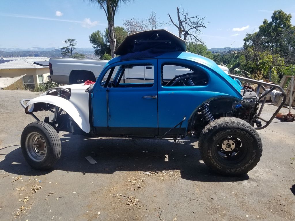

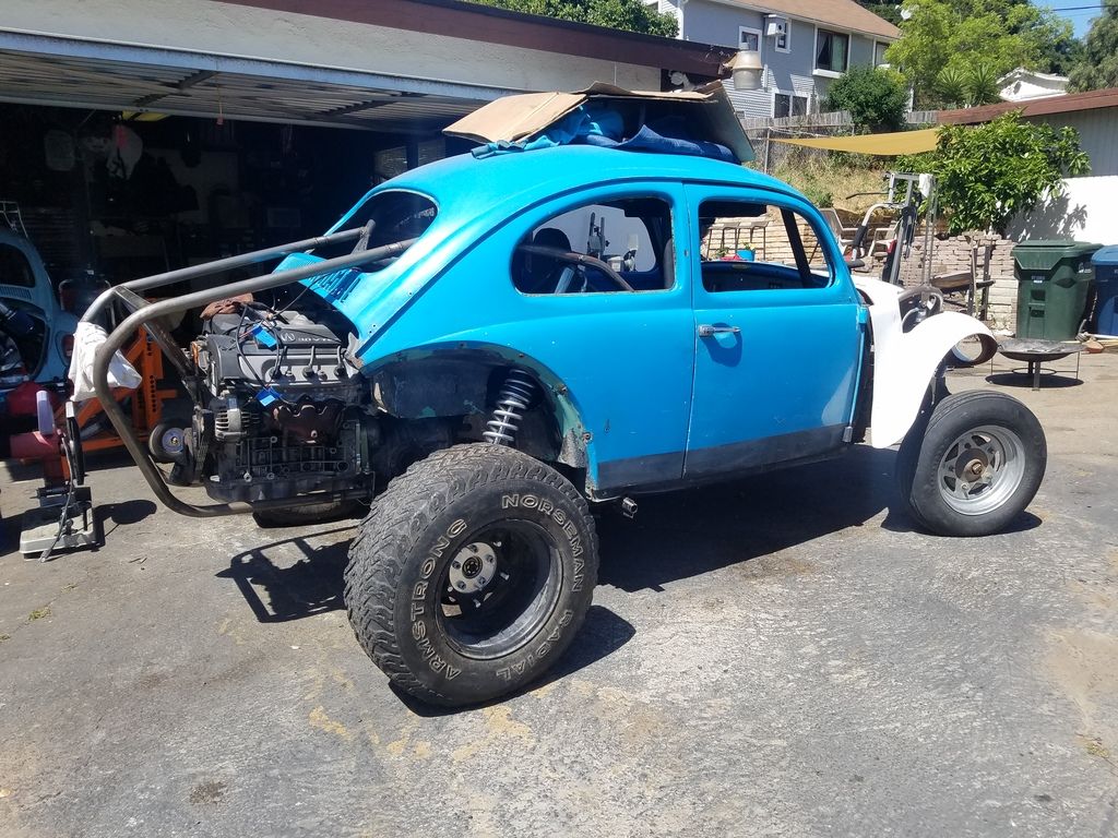

I suppose i should get this caught up to where i am today. its been a slow build but over time i got little things done here and there.
i took my sweet time getting my shock hoops built and shocks mounted. but i did finally get them all situated where they needed to be
i dont have a ton of pictures of the little things i did here and there along the way but i have some pictures of how it currently sits
my current goal is to get some wiring started for this thing at least while im waiting for my radiator to show up its been on backorder..
the only things i can think of that arent in these pictures that ive done since are the front shock hoops have been braced, i got a front disc brake setup, got my battery box mounted, started a fuse/relay panel, and my tail light mounting set up is one of a kind.. Cool
