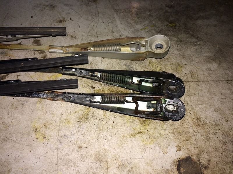

Some small mods: upgraded existing wiper assembly (lock screw arm, lower 2 in pic) to newer style(spline type arms, upper arm in pic) hopefully for better windshield contact pressure, these have bigger hold springs than old style.

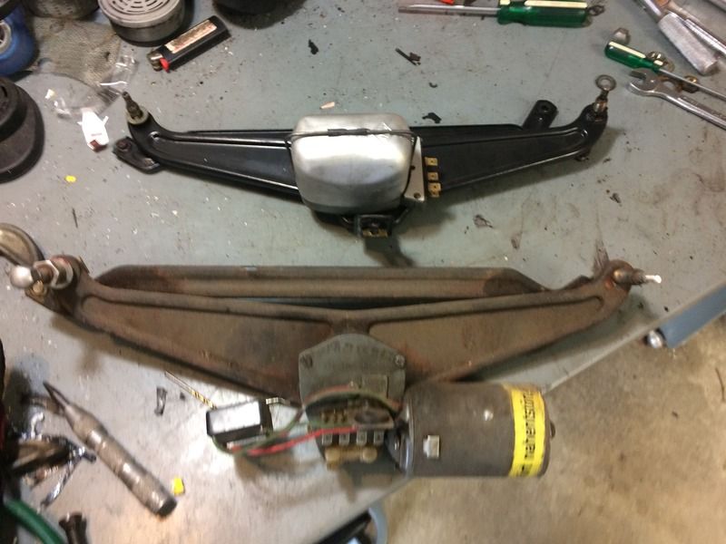

Modified existing wiper motor assembly for spline type shafts/arms because I knew what shape it is in plus it's clean/painted, Upper 1 in pic is older style w/lock screw type shafts. Removed spline type shafts (lower assembly in pic) drill holes a little bigger & installed shafts in old style assembly. Note:this was a "before" picture

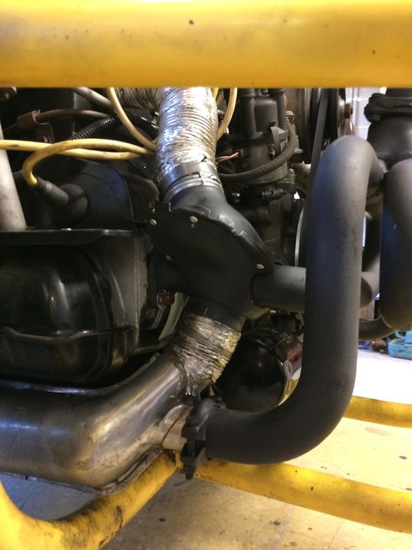

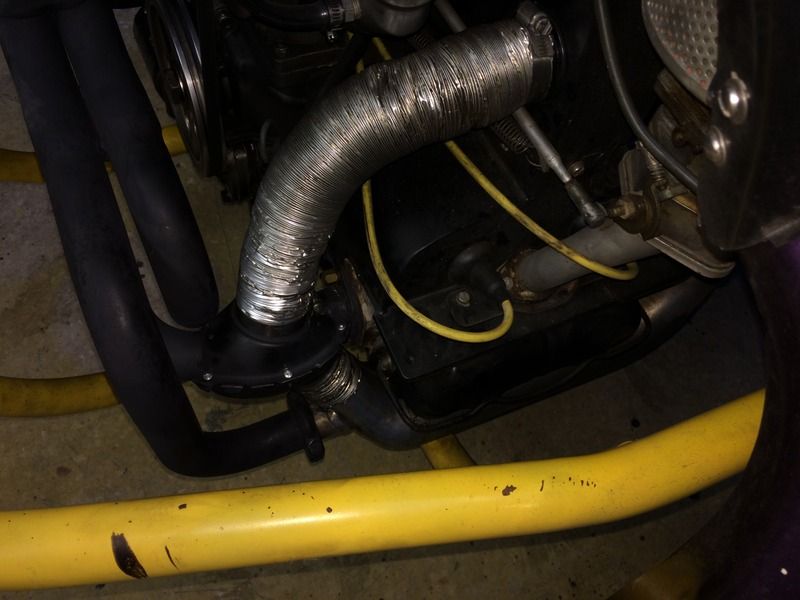

Added/modified rear (smaller) heat boxes over stinger exhaust system for a little more heat. Starting to get cold here in NC
