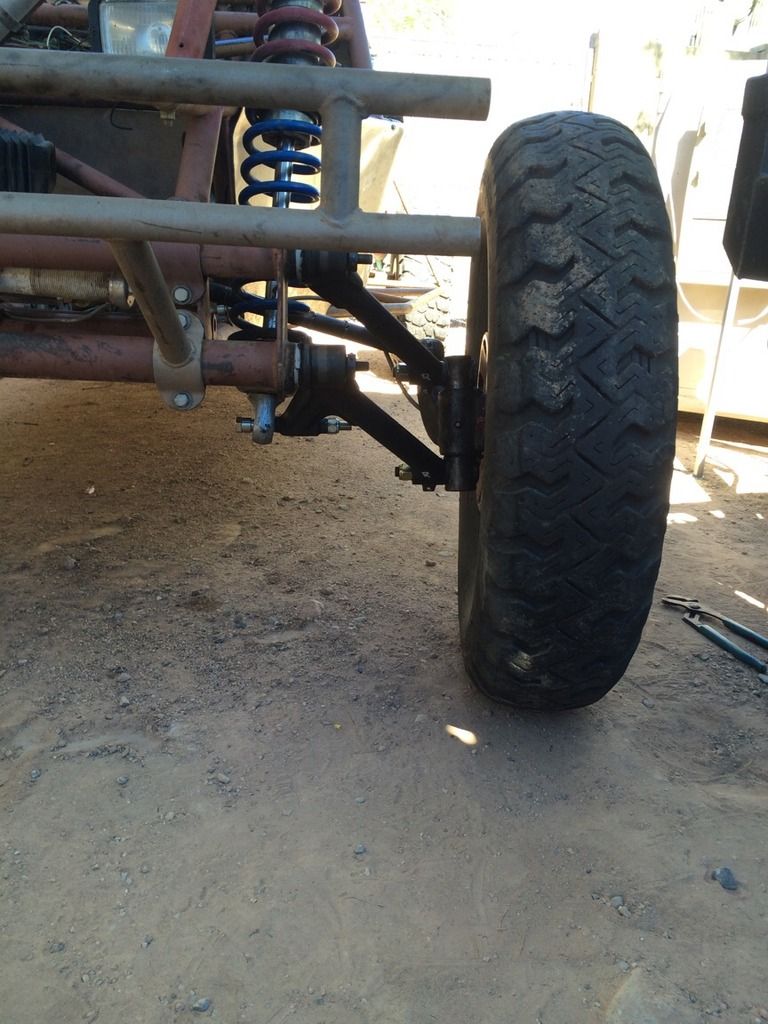

I think I'll need to change my spring rate and ad a shim
Or 2 to the valving, those arms crush my springs right now. I have the arms on and I ended up using 2 shims on the outside of links and the inside at bottom for thrust wear,and tightening down bottom links I measured actual gap I had at the top link and added the correct amount of shims to fill the gap so I know my links have zero bind, I just finished lengthening my tie rods 2" so I can set toe then I will be able to set camber. C/k sounds good let me know
Picked some hardware up today and the +2 tie rods I mocked up fit perfect, I set the toe and camber looked fine. Went for test ride last night and it drove str8 and gr8, I can't wait to see how it feels in the desert. Ended up putting the #350 springs back on, they feel more linear with less preload
Changed springs, bearing service new seals. Cycles 14" tie rod limited

Took it up to crown king over the weekend, I will have to revalve the shocks or or try a 20wt oil. Ride was good but needed way more valving
