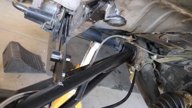

So I decided a while back to re-do the rear suspension to a more traditional shock setup through the wheel wells. It was a pain to go back to the drawing board, but I'm happy with the ride now.
While I was at it, I added 2X2 tubular arms from Appletree and added some disc brakes.

That looks good. What brand of brakes did you use? Did you leave drums on the front

Those are EMPI brakes with the e-brake cables. The cables do fit even with the 2x2 arms. The rotors are the ones with some extra width to them. I'm using drums up front.

So tell me what you think...I came up with an idea for a bump stop and a limit strap combined. I cut off the stock shock mounts/bump stop combo (this gets cut off most of the time to give clearance to longer shocks anyway) and had the idea to reverse them.
Notice this one is backwards.. It turns out that the stop will contact the trailing arm and the bolt hole may give me an option for a limit strap down the road.
We added a verticle brace to support the arms when contacted.
Generic bumpstop for now.

I found the EMPI part number: 22-2927-F
There were a pain to bleed because the bleeder valve does not sit at the highest point unless you bleed them off the brackets. Just position the bleeder valve up top, bleed, then bolt them up.
