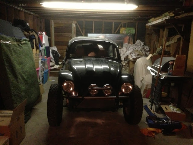

What I currently have. 1970 VW Beetle, IRS rear link pin front with raised spindles. Disk Brakes in front, drums in back. What i think to be a 1914cc engine *will be opening her up to verify* the transmission, don't know. I'll have to look into it. The rest is pretty standard fare aside from the front link pin being a nice set up for an adjustable front end and having a brace for the shock towers that i need to re-weld...
What I plan to do with the bug is put in a roll cage that ties into the rear cage. Remove the gas tank that currently sits up front and move it to replace the back seat. clean up all the fiber glass and put in a roof rack that I'm currently talking to corralean about. *another forum member here has one that turned out super sweet.* Also plan on going with a dual webber set up currently have a single 40 IDF.
So History behind my Baja Bug is that I bought it about 5 years ago, at the time the only repair I had to make on it was the throttle linkage broke on the inside of the tube. It was repaired at a shop because I was not in the area when it happened *I had just joined and reported to my first unit in the US Coast Guard. I then towed the baja from So-Cal to Neah Bay Washington. Soon after i had issues with the engine not running right and was forced to abandon doing any work to it due to parts availability and delivery issues in the remote area I lived in. After my first unit i moved to Seattle for my second tour. I didn't have room to store/work on the Baja so I took it to my parents home where it has sat...until today. I am extremely happy to see it again and to finally get to do some work on it. So to start off this build I will be calling it "Lucky 13" due to the year that I finally get to put some work into her and also happens to coincide with 13 years I've known/been with my wife.
The first thing i want to tackle on my build is what some mechanics up in Port Angeles washington did to my lube oil pump. I have an external lube oil cooler that i know they blocked off but i remember they took something out of where the pump goes, I have yet to open it up, probably will do that tomorrow after i drain the oil. If anyone has any guesses on to what it could be...by all means.

So today I spent some time with Lucky 13 figuring out what I wanted to do and just a look through of what i had.
Carb is a 40 IDF weber made in Spain. I need to rebuild it, make sure it's properly jetted.
Engine looks really greasy and dirty on the underside, where the case meets, I am unsure on weather this is due to the oil drain plug/filter not having a good seal or if i'm leaking through the case half's. It does however look like the oil i put in since last oil change back about the time i dropped it off at my parents is still there lol. The oil *from my experience as a mechanic in the coast guard* looks clean and the level looks the same. This makes me think the engine is not actively leaking, or the oil/dirt that is on it has plugged the leaks. I plan on cleaning up the underside of the engine next.
As far as rust on the body, none other than a small hole on the drivers side forward wheel well, i'm planing on patching. Pans are good except under the battery. It looks like the previous owner put a new quarter section in, but I am not sure if he just dropped that piece in, welded or what he did.
Either way he did a crappy job because on the underside the rust broken area is still there, wasn't cut out and wasn't dressed up in any way. I plan on removing the carpet and probably buying a new Quarter Panel/battery tray area and fixing it properly. Other than this the car seems pretty sound as far as rust goes.
I'd like advice on what to do regarding the carb. I really want to get a dual weber set up but not sure if it's worth it without having a 1914cc engine. *I don't know if I do or not* I really don't want to spend money on fixing the engine up if I open one head and find that there's damage on the inside, but at the same time I might prevent more waste of money if I don't.
Anyone have any thoughts, would be greatly appreciated.
I'm getting my Picasa Account set up and I'll have pictures to show soon.
Thanks everyone who replies.
