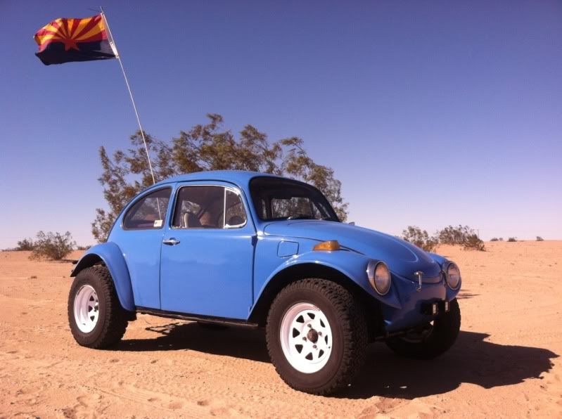

Went to Gordon's Wells yesterday for a shake down/maiden voyage to the sand!
She did pretty good, better than expected actually. I have the alt stand baffle in backwards, so I was expecting the oil leak that developed, & I think I over compressed my R/R shock, it's puking oil all over the trailer now (Time for some bump stops) but aside from that, she ran great & buzzed through the dunes quite well. We drove all the way to Ogilby, got back on the highway & shot over to Patton Valley, then up & down sand highway a few times, playing around in the smaller dunes some.
We're gonna head back out in two weeks for the weekend, so I've got some kinks to iron out & few fixes, but nothing major.
