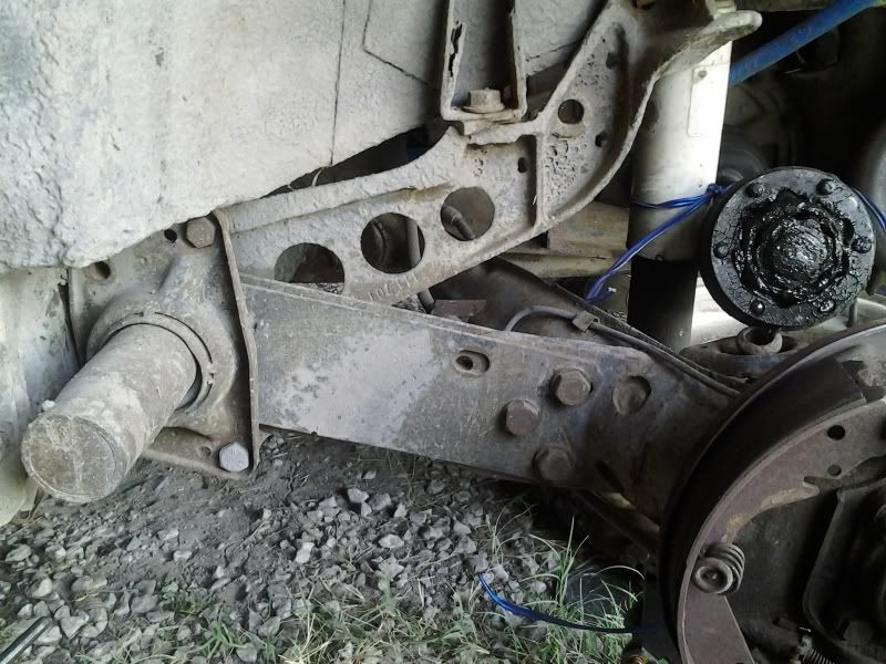

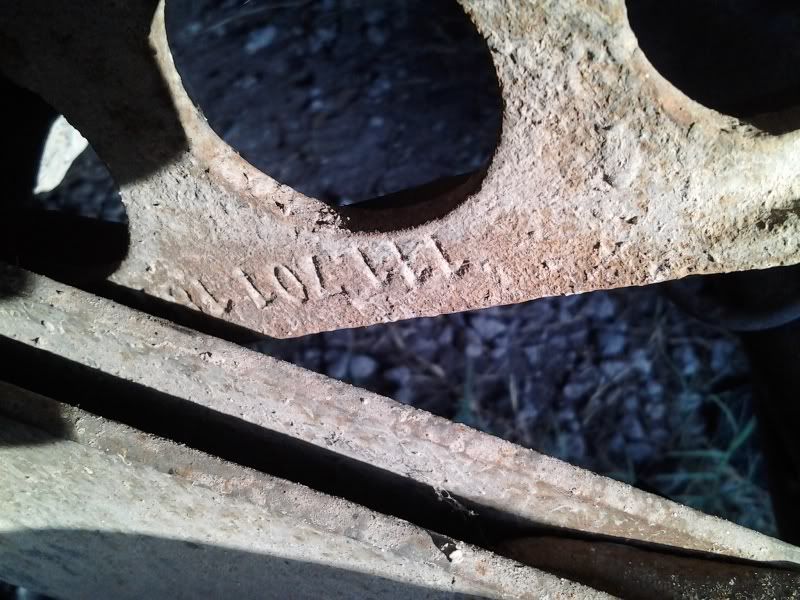

I have a Baja with the VIN under the back seat says it is a 66. It has an IRS on it, It is not stock. so can anyone tell me what the number on drivers side rear shock tower of an IRS rear end
means if anything?
This is the number on the shock tower
I was told the brake drums are too big for a standard bug but it might be from a bus?
I need a new axle but not sure what to oredr.
Any help would be great!

this is another view of the rear end.
if other pics would help let me know.
Post Post subject: Number on the shock tower
Posted: Wed Jul 25, 2012 06:03 AM
Looks to me like a 66 pan with an IRS conversion. Some pictures of the pivot clips might help.

if you look in the pic I am trying to get the rear axle out, the spacer between the bearings is stuck to the axle. If I need a new one, one from a 66 wont work because this is an IRS and in 66 they were swing axles. Right?
Posted: Wed Jul 25, 2012 07:03 AM
correct. 69 and up, IRS.
the piece you are trying to get out is actually the "stub axle". it actually has a bit of a press fit, so some slight "love" with a hammer may be necessary. i'd use a piece of wood or something so you don't mushroom or ruin the threads on the stub axle. there is actually a puller made for doing this, but the hammer method has always worked just fine for me.

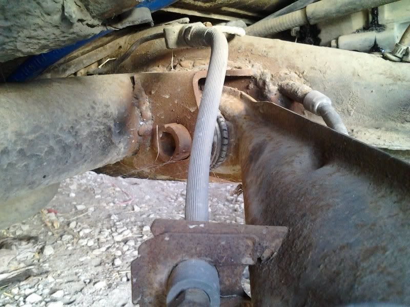

Ok, this is the pivot clip/mount.
Unless my grandfathers uncle was a crappy welder this was replaced (back in the day I had a few relatives that worked in the VW factory).
This is the whole drivers side.

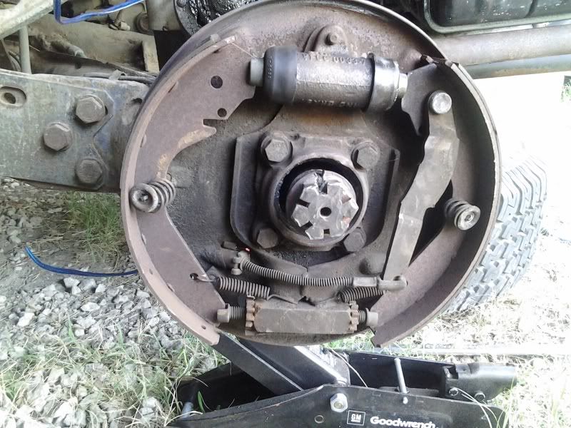

I was told the brake drums were maybe from a bus?
I need to replace the bearings and brake shoes but I don’t know what to get.

the pivot wasn't actually replaced, it was added in. So your 66 pan that originally was a swing axle has been converted to late model IRS.
i'm not positive on the brakes but they could actually be Type 3 brakes which are bigger than Type 1. Look up the part number on the wheel cylinder and compare it to what it might be.

Posted: Thu Jul 26, 2012 03:07 AM
- Pan is 1966.
- The 111 ... number on the tower is the part number of the tower forging. And YES, They are forged. many people call them castings, but they are definitely forged. They can be welded on, no issues, MIG, Flux Core, Stick Arc, etc.
- The IRS pivot brackets are aftermarket, not VW. they were welded on by some individual in the 1980s or later.
- The brakes appear to be VW Type 3. If the drums are 5-lug, the brakes are 1967 or earlier T3. Get brake parts for a T3.

MojaveRacer208 - the drums are 4 lug.
i did get the nut off with a drill and a good cold chistle.
JWHracing - "Look up the part number on the wheel cylinder "
im not sure of the location of this number.
is it stammped some place?

There is a number cast in the upper side of the wheel cylinder shown here. It would have matched the original parts list, but may not match modern lists 45 years later. They may have been replaced somewhere along the line. I would expect the number to start with "311". Two factors important in swapping VW wheel cylinders around is the working length from the bottom of the saddle for the shoe on one end of the cylinder to the same point on the other end, and the offset dimension from the centerline of the cylinder to the face of the shoulder for the backing plate.
And there is a spreader bar for the parking brake and the return spring which goes with it missing in this brake assembly. The "nails" for the shoe retainer springs are bent, maybe from the other pieces not being there.
