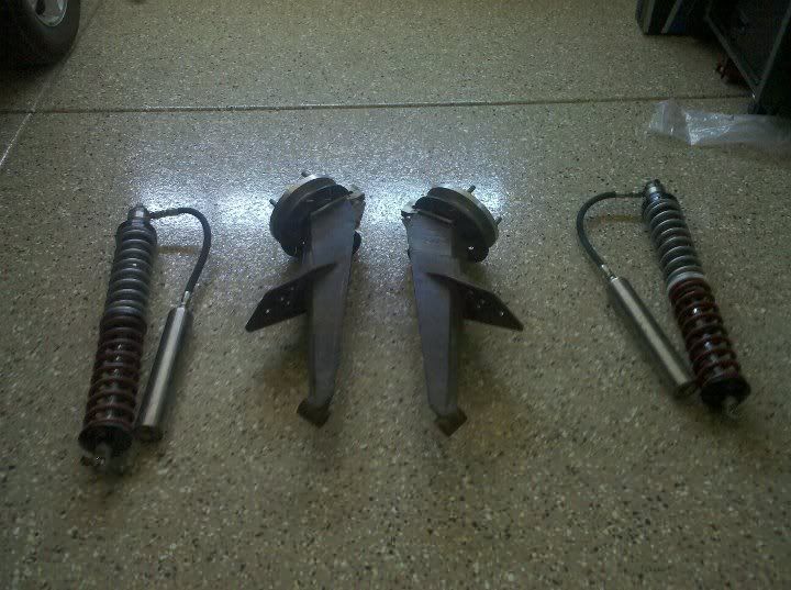

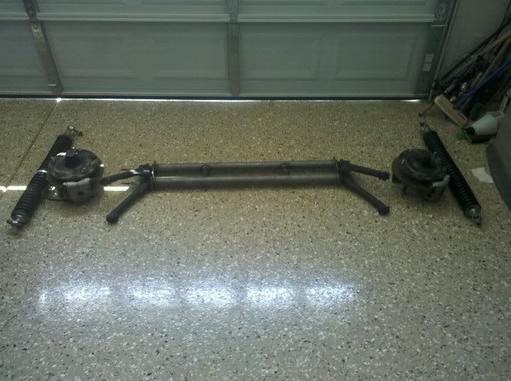

Well the last couple months ive been picking up parts to build my baja. Ive finally got enofe parts to finaly get started on it
as she sits right now

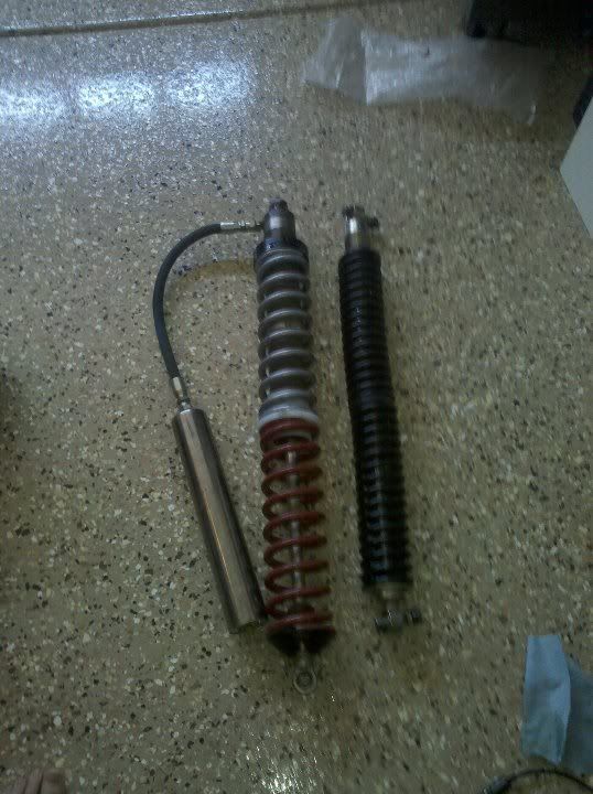

Suspension
Coilovers
Blistine 9100 12" body 14" travel 2.65 with 3.0 coils/ FOA 2.0 with 2.0 coils 10" body 10" travel
front suspension
FOA coils, empi disk brakes, beefed up spindles, 6" wider beam, 4x2 trailing arms
rear suspension
Blistine coils, Gear one 4 piston disk brakes, american made 3x3 trailing arms, 930 stub axles

Welcome. Thanks for the pictures. Looks like you be up and running in a few hours.
