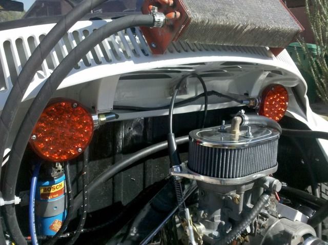

Rybob wrote:
I didn't mount mine to the rear cage i mounted mine higher up. I used LED lights (same size as crestfallens) only difference is they are dual filament so mine act as taillights and brake lights. Easy install (we bent a piece of aluminum angle iron and drilled up into the support right above them) and they sit higher up so i am very happy with them. Brighter than crap too, When i hit the brakes at night i can turn around and see the red glow on everything within a few hundred yards lol. Laughing
heres a link
www.pacificcustoms.com...5192R.html
Heres some pics
Hey rybob
I mount my taillights just like yours
Mine are dual filament too
How do I get them to work for 3 functions
Tail, turn, brake
I have a trailer tailight converter
Is that what u have in your bug?
I have no idea how to hook it up
Help anyone?!?
Lifes a bitch an then you die

yep exactly what u need. its very easy to hook up. o if u want u can make a delay for your turns switch

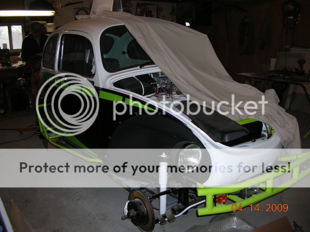

pictures!!!!!!!!!!!!!!!!!!!
so when i first got my baja bug it looked like this
