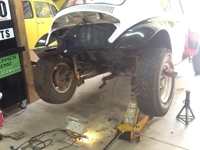

Making some progress....finding more rust.

SillyImportRacer wrote:
Suggestion...(for other Baja guys too)
While the car is apart, reinstall the rear bumper and the motor mounts. Then weld the bumper brackets to the motor mount. It makes it WAYYY easier to install the bumper each time. You won't have to re-index the brackets on the big motor mount bolts. For offroad or even sporty street driving,especially with bigger offroad tires, a steel motor mount cradle is highly recommended. This is even MORE important on a swingaxle car because the suspension pivots on the gearbox, but it applies to your 69 IRS too. It's EZ to do this with the engine out. Damned difficult with the engine in.
Nice garage and nice paint scheme on the Baja.
Another tip for others when cutting Bajas...
Note in the picture above that the rear inner fenders are cut away between the fender flange and the firewall. This triangle of metal is best left in place to resist flexing of the fenders. I add a brace that runs along the edge of the metal and out under the fender Those $0.79 shelf brackets from the hardware store work well and are very inexpensive. For this car, since they are already cut out, a brace which extends to the bottom corners of the remaining inner fender panels would do the job. Rust can be an issue for braces in the rust belt. Truck bed liner under the fenders helps.
