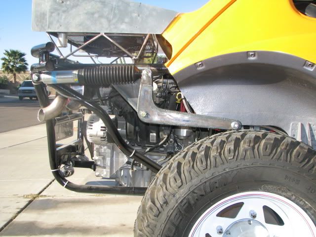

Post Post subject: Re: Carbon Footprint...aka Suburban Legend Baja Build
Posted: Wed Mar 16, 2011 07:15 AM
Now some of you may have noticed the odd location of my shock absorbers...If not, take a loooong look now....
That right there is a custom, cantilever suspension. If there's another one out there in the world (on a Baja Bug)....I haven't seen it. Have you? I would be curious to know. (I just googled "Cantilever suspension Bug" and got like zero hits... Cool )
Anyway, he did an AWESOME job. The arms allow the suspension to move its normal 7-8 inches while only using half of that travel in the shock. It allows smaller shocks and obviously a different placement. I didn't have to cut holes in my body panels to add a longer shock....very cool. Here's some close-ups of the handiwork.
I like how the shocks are tucked inside the arm, and hiem joints are used to connect the trailing arms to the cantilever.

I am pretty new to this stuff, but i have never even heard of someone doing that with their shocks! Shocked Looks awesome though!

Nice job. I'll see if my friend has any pictures of his race rail that had double a rms and cantilver torsion bars.

The shock is very F1 race car. Also a few other high end kit type cars us this type of spring an shock mounting to lower body lines and clear tight spots.

Nice set up.I have seen a class 5-1600 car with a set up like that, it has dual shocks mounted in the package tray area. I will see if I can find the pick I have.
I love the Bell-Crank shock mount, very F1!! I'm totally stealing that one when (if) I build a Baja.
