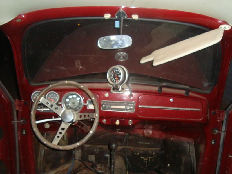

Howdy everyone. My name is Matt, I've been wanting to build a baja for a LONG time. Mostly been into CalLook VW's up until this point. I live in Chandler with my wife and two boys, Jen, Max and Jacob. I was a firetruck mechanic in the Air Force for ten years and now run a plumbing business in Ahwatukee with my stepdad.
I found this '73 on craigslist two nights ago and had to snag it. The body is garbage, the ball joints are maxed out and it is missing an axle. However- it is an irs chassis with a single side cover tranny. I have an original German link pin frame head that I am going to swap out with my own homemade extended travel beam.
The baja was only $600 which was well worth it considering it has brand new 31/10.5/15 rears and 225/75/15 fronts! It also has a new wiring harness.
I know this is what they all say but its going to start as a fun desert car for the family to take on camping trips, but I'm not limiting myself. I'll let it tell me what it wants to become Laughing
I'm pretty handy with my hands, so I usually make ALL of my own parts. I hate buying something when I can make do own my own most of the time. We'll see when it comes to the cage. I'll probably build a bender and have a go.
I'll be using my '65 body on this project as its in pretty good shape. I have the 2276 48 IDA'd motor that I'll be using as well. I'm not sure how dual 48IDA's will work off road but I'm willing to give it a shot!
Anyway, here are the pics of the car I brought home. Honestly it looks like the guy used a HATCHET to cut the body for the 1 piece front end!
