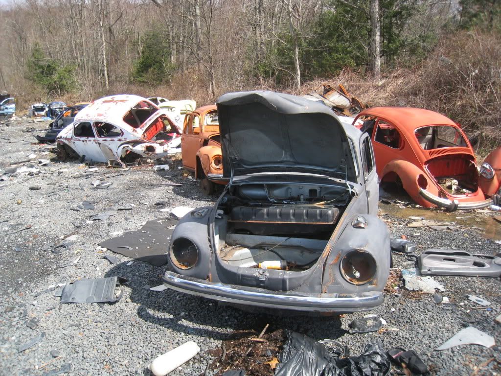

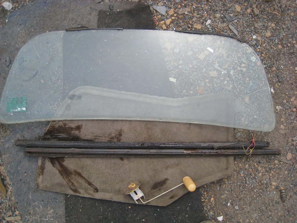

DAY 2 and 3
600 miles ahead
never mind the glass...@!@#!i stepped on it!@!@!@!
its a second one after orig. i touch and it breaks
I am beat up!!

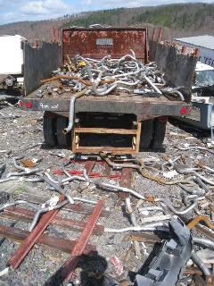

plus trip to junkyard
go basis for 1600 single port turbo w/ garrett and inc
total damage 150 bucks
THIS IS BASIS FOR 2ND MOTOR
it is goins to be crazy
and thats the game plan
