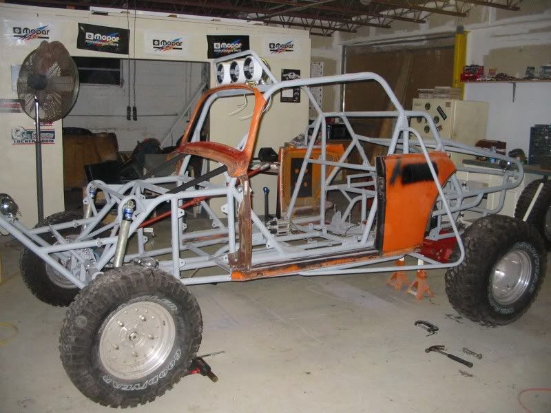

Here is the best pic I have to explain what Im talking about with the door pillars. My idea is to cut out whats left of them just under the bottom area of the windsheild and cut a piece of 3/16 or 1/4" steel to replace the door pillar and just bolt or weld the hinges to it
This is my idea to fix it
If anyone has a better idea or can think of anything I might want to consider please let me know. Im open to all ideas

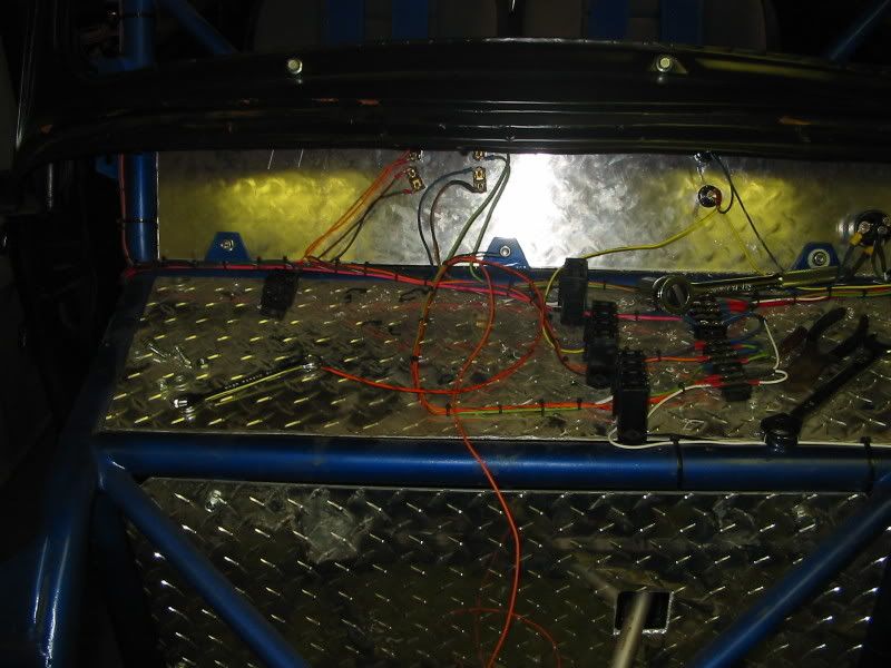

Not sure if you can see what Im talking about in this pic, but when I cut the diamond plate pieces to enclose the footwell area I left a 1/8" gap all the way around it so that the aluminum didnt move and start rubbing on the tubing. You would be amazed at the amount of water that comes through that gap when you hit even a small puddle at 60mph lol. Even though I like how easy the panels will come off, I havent had to take them off yet, so I am considering just siliconing the gaps. But I would rather do it in a way that still allows me to remove them if anyone has a better idea
When I do the panels I cut 1/4 or 5/16 rubber hose. I cut it up the length
and slip it over the panels. you can use wether strip glue to keep it in place on the panels this keeps water out good and you can still remove them

Thanks thats a much better idea than the silicone. Now that I am going to be keeping the baja, I should be ordering some new seat covers from you soon.
