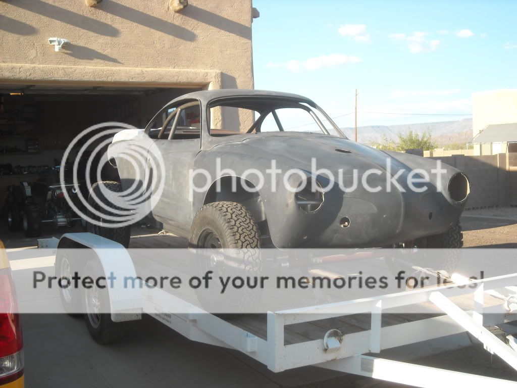

This was last Sunday. Ghia is loaded up and ready to go in for paint and finishes. As we speak, it is at BajaWarriors place and Scott is working his magic. Can't wait to see it come back.
I hope to get some work done on the motor tonight, so will post more on that later.
