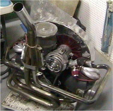

the motor
allmost done so, let me know what you guys think!!! Shocked

if he does choose to run 5x5s, would he be able to put in a bus tranny to get the extra length he needs? i know they are longer but i dont think its that much longer.

The flanges are in about the same place as a type 1. The reason to move it back is to get less compound angle on the cv's.
Post Post subject: Re: progress of my longtravel bug
Posted: Tue Dec 01, 2009 09:16 AM
Bus transaxles are wider than the stock VW IRS so your Half shals are shorter with a Bus Transaxle. With shorter half shafts you get less wheel travel do to the incress of CV angles. That is why you go to 3x3 arms etc. to incress the length of your half shafts. The longer the shaft the less the angle at the CVs for the same given amount of wheel travel.

You don't have to move the transmission with 5x5's
