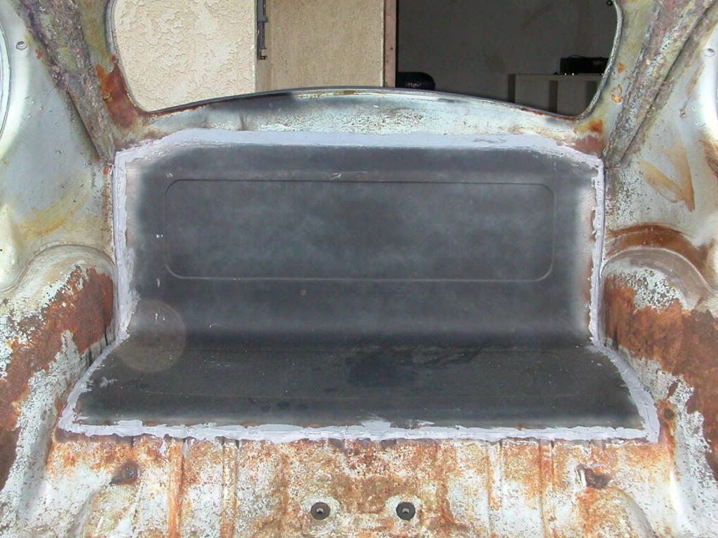

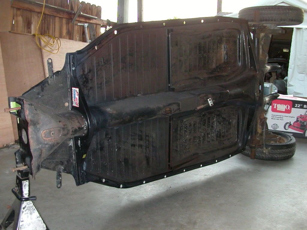

Ok guys this stock 69 bug was bought as a driver that the PO couldnt figure out why the car was running like crap, he thru a bunch of money at it (09 dizzy, new coil, rebuilt carb, voltage regulater)if you gave it a shot of starting fluid it would fire. I paid $400 for it, drug it home stuck a fuel line from the pump into a can of gas and it fired right up, fuel line was plugged somewhere in the tunnel. I bought this in 05 with the thought of making a baja out of it to leave at my vacation home in Parker Az. Never got around to doing much but yanking the interior out and finding that there was quite a bit of rust in the luggage compartment shelf and passenger side pan. So I knew I wanted to go with a link pin beam so I decided to cut out and change both pans, front cross member and a new link pin frame head. I dont have any pics of the deconstruction because my computer crashed a few months ago and I lost all my pics that I didnt have saved to photo bucket, so we will start with todays progress.
Got all the final welding done on the pan.
Finished patching the luggage compartment shelf.

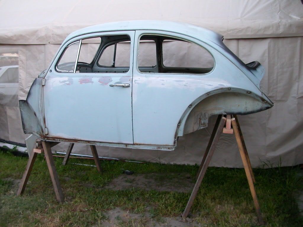

This is the body as it sits now after cutting it up.

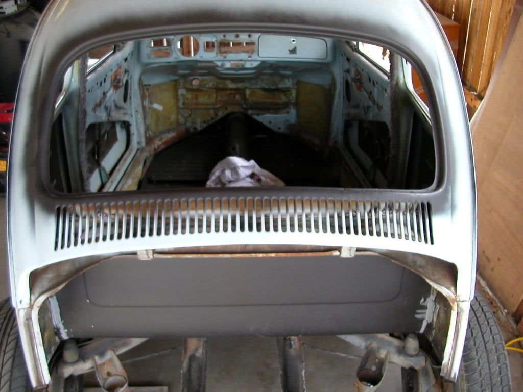

There was some rust damage around the bottom of the back window that I fixed. Im pretty sure that is how all the water got in to rust the floor and luggage compartment.
I've got a one piece front and a three piece fiberglass rear kit. Thats about it. Im going to clean and rattle can the pan tomorrow then start working on the inside of the body. Im unemployed right now so I've got to keep my spending in check. But as soon as I get back to work bring on the suspension.

Finally got the pan seam sealed and in primer.
Not sure what im going to do for final finish on the under side, maybe just bed line it all top and bottom. Well on to the inside of the body with a wire wheel to get rid of all the left over insulation and surface rust.
