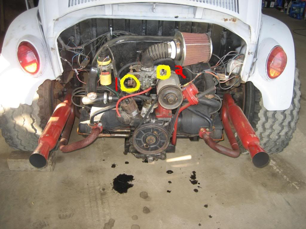

hook a wire from number 1 to number 2 and number 2 to the + side of your coil
thats how mines set up its for and its for your elecitic choke

The pic isnt workin for me?
Post Post subject: Zacks first bug
Posted: Fri May 15, 2009 03:37 PM
Yes, that solenoid will absolutely affect idle on a PICT carb. I had a '65 one time that wouldn't idle for crap without that wire. As soon as I installed it, she purred like a kitten.
I can't see the pic either. Apparently cyberjaw moved it to another album or something and broke the link.

so am I just gonna run a wire from the solenoid on the carb to the + on the coil?

ok sorry got the pic back up

all a vw needs to run is air fuel and spark, shouldnt need anythin on the side of the carb. should idle fine. as far as my knowledge goes. i got no wires there! sweet bug btw!

THAT sylonoid will ABSOLUTLEY MAKE YOUR CAR NOT RUN. It's an "anti dieseling" sylenoid. With out that working properly your car WILL NOT idle. first take it out and clean it all up.. If it's bent, try to straighten it, Put power to it and the little rod that's on the end will move in and out it will also make a clicking noise if it works.. If not buy a new one. I would reccomend going to autozone and buying their gallon tub of carb cleaner, It has a nice basket inside to lay all your parts on. Take everything plastic or rubber out of your carb and put the carb into this jug and let it soak for an hour or two... than rebuild it with all new gaskets and such....
That solenoid is what keeps the car from spitterng and sputtering when you shut it off, (like it still wants to run a little after the key is off.) This also keeps your car idleing if everything is adjusted properly, I had the same issues with my carb until I soaked it put on safety glasses and blew out all the little holes in the carb and than found that my sylonoid was bent, so I straightened it and it ran perfect once the carb was adjusted.. and yes I believe it goes from the sylenoid (Or how ever it's spelled.) to the + on the coil.. Smile also check timing as that can play a big roll..

Still have the problem with the carb(wont idle). I checked the diesling sielnoid. Took the carb out cleaned everything. With the automatic choke, I read in VW book how to disarm it. It says to loosen the 3 screws and turn it until the butterfly is open. To get my car to idle I have to turn it until the butterfly is almost completly closed, If it opens just a littlebit the car dies. Im not sure what to do.

the spot for the wire, as you put it, is on the choke I believe, which means you may have an electric choke on your carb. if this is the case, it won't be activated because it needs the volts. Nice thing about them is they shut off automatically when they "sense" the engine is warm, problem is it's another electric thing in an open area bound to see rain, mud, dirt, snow, etc. When you purchase your new carb, go with a manual choke.
this will cause problems with startup initially because of the lack of choke, or if it was deactivated while in the "on" position, you'll have really bad performance once the engine is warm.
good way to tell is if the idle is abnormally high and if you can smell the gas (smells unburnt) coming from the exhaust. If you have any residue on your hands from the exhaust, that may be a sign of the choke being on as well.
looks like your first priority is re-routing the fuel line all proper, and then get yourself a new carb!

Put the new carb in and it actually idles and runs. I was sooooooo excited. Finally took it for a ride in the field. Its awesome!!!!!!!! I love this little car. Can't wait to get the brakes done.
