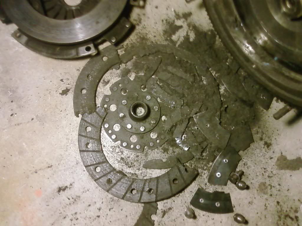

She's doin good man! up and running like a champ again. Took a little work to get there, but nothin too bad. Mostly my fault after I seized that 1835. Lol! BUT, I got the 1600sp that I bought for 200 in a while back if you remember. Then, I was just having carb problems. Hadn't had a chance to do a while lot for a while what with family coming for Thanksgiving and a lot of crazy stuff happening at work. So, 2 weekends ago, I decided to drive it to my old man's house and pull, dip, and rebuild the carb. I was headed to my buddies at about 4am so we could go fishing, then I was gonna go around the corner from my friends house after to my dad's and take care of business. WELL, on my way to my buddies, I was coming up to a red light, so I downshifted and held in the clutch.... Well, all of a sudden... BOOM!!! Something snapped and sent me into 1st gear at about 40mph.... D'OH!!! No more clutch... so much for my plans. So about 5am my buddy showed up and towed me to my dads with me about 2.5feet behind him the whole 10 miles or so RIDING my brakes so I wouldn't bump him. Another one of those dumb mistakes. lol! So, finally get to my dad's. Pulled the carb and dropped it in the carb dip while I started pulling the motor. Here is what I found...
YIKES!!! Shredded clutch disk. I wrote it off to just being old and sitting in the sun for a while before I bought it off my boss. Put in the new disk, pulled the carb out of the dip, rebuilt it and thought I was ready to rock! Tok off down the street... Uh-oh.... PUMP THE BRAKES!!! Lol. Had hardly any brakes at all. Flipped it around and headed straight back. By the time I got back to the other end of the cul-de-sac, there was brake fluid EVERYWHERE! Turns out I melted the right rear axle seal and destroyed the cylinder on the same wheel. No big deal, had an extra cylinder or two from when I had my sandrail. Put that in and went to BAP and bought a new seal and put it in as well. Now she runs great! Real smooth. The only thing that needs attention now is the right rear tire. It goes flat overnight. No biggie though. My dad had an extra 31" BFG all-terrain laying around that was brand new. He had it as a spare on his pickup, but has since gone back to a little smaller tire. Just got to go get it mounted and balanced.

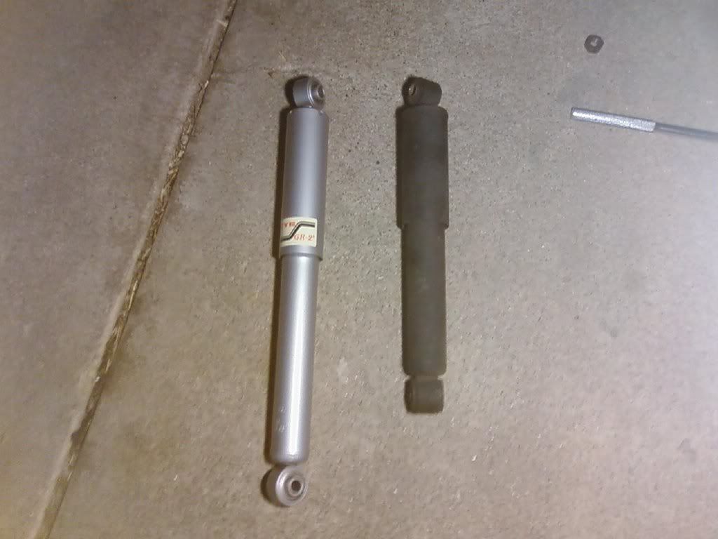

On another note, I got the new shocks in a month or so ago and installed them in the rear too. Makes for a much smoother ride when you have a shock on EACH side. lol.
Before and after.

Bad Clutch....
