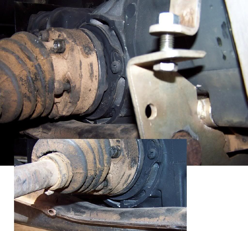

Hey give me your thoughts on this idea. I am thinking I want to redrill the big frame horns holes and drop the tranny down 1/2". I have the room at the cv's.

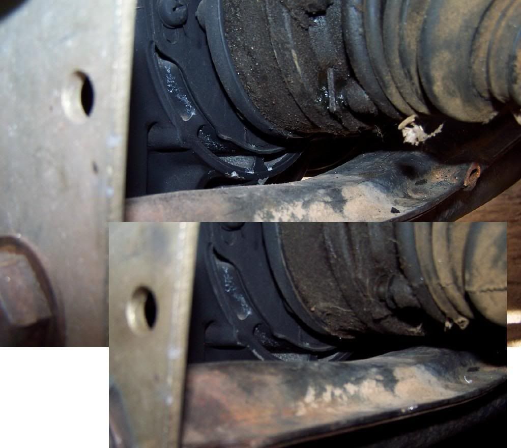

IT WORKED....
Droped the motor mount 1/2 inch, the axles are now at 12 degrees. could have gone a little more but I got what I wanted,,the valve cover is off the rear deck.
Right side before and after....
Left side before and after...
