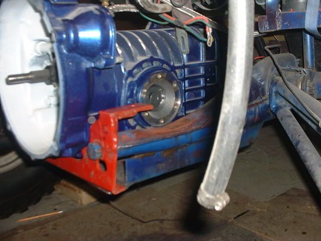

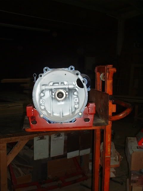

You guys who have moved your tranny left or right to center the drive flanges, did you all move the foreward mount or left it at an angle?
Here is my forward mount where I notched it for clearance. Sorry not really good pictures.
Here is where I am going to cut and lower the tranny in the saddle
edit: got some more done.
Got the mount dropped down.
The frame horn notched.
Yea don''t bust on my welding, well unless ya need to.
And how close the drive flange is, lowered it down about 3/4 of an inch which helps on the CV angle.
Close but does not touch the frame horns Very Happy

"You guys who have moved your tranny left or right to center the drive flanges, did you all move the foreward mount or left it at an angle?"
I am moving mine over but not down. the nose cone mount will be going away.
