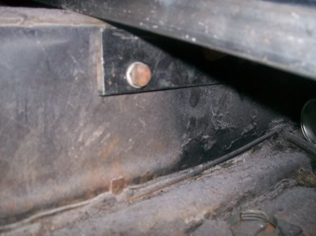

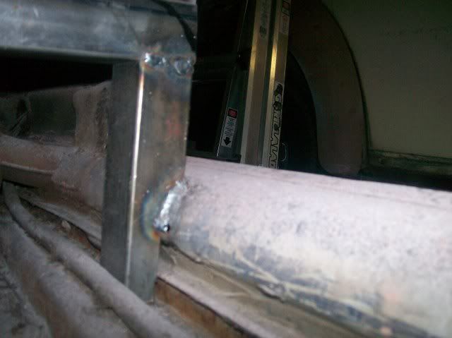

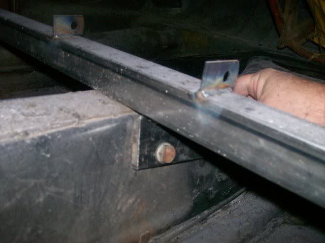

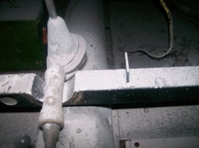

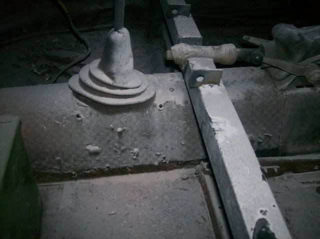

Here are some pics of a frame it is welded into the side of the body and it attaches to the seat belt holes in the tunnel. The seats will bolt to the frame and provides the height. The frame is notched out in the front for the e brake there are plates that will still bolt thru the floor but this is a very secure way of mounting without having a cage.
Front
Side
Tranny tunnel seat belts
