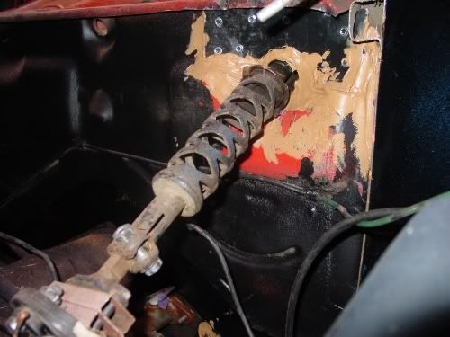

That's where some of it curved out. You can't tell too much but, that's it. I wil give a better picture tomorrow and hold a ruler to it so you can see the gap. Maybe I just overtightened it. I think part of the problem was that my kit was not a sold kit. It was a piece of metal bent into shape kinda like this---> ] looking down it and then small tabs connecting the gap here and there. It is thin too. I'll post a picture of that tomorrow too. Its cold outside, haha.
That is my steering column where it connects to the steering box. After I cut the firewall I used part of a metal plate for my emissions filter or whatever it was to cover that side. Then my old man even put on that brown stuff to seal the gap. On the steering box, you see my way of connecting column to box to compensate the gap without adjusting the box too much.

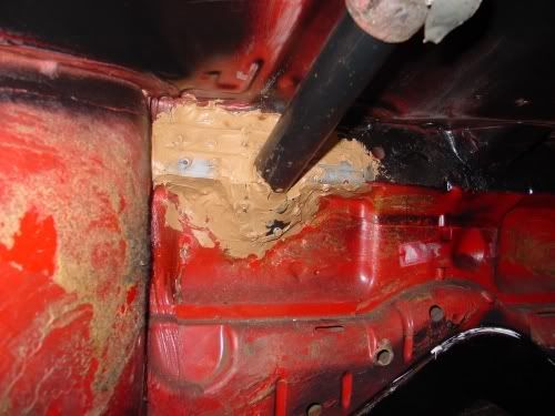

Interior where the column goes in through the firewall. Random piece of metal used to fill that side of the hole and more brown stuff. Works fine now.
